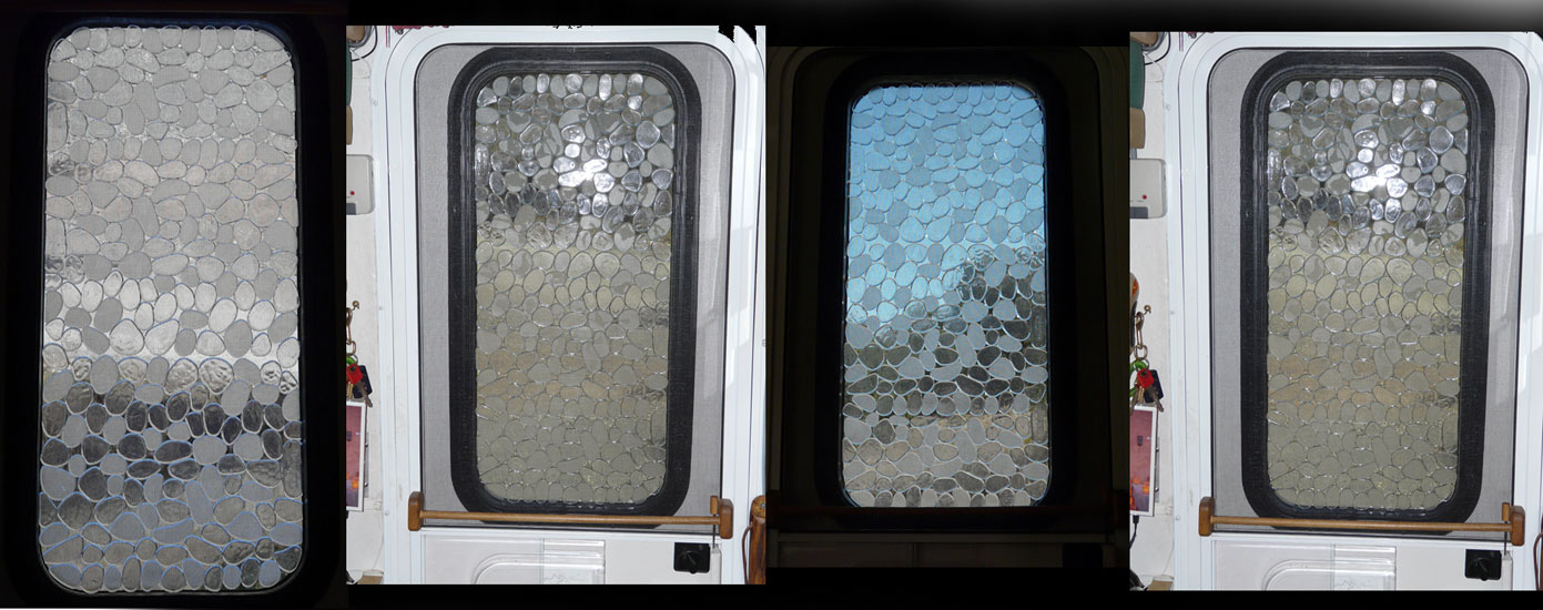

As to the front door, we put the stained glass film from Home Depot on it, but for me, it was just too dark.  Andy decided to try some sink mat material in Skylark, and while I liked the way it looked, I wanted more coverage than he did, so I used the same material he did, but ended up cutting it up to get full coverage on the window in the door.  I like the privacy it affords, but we can still look out f we try really hard.  I took several photos so you can see what it looks like at different times of the day.   If you want to see it, here's a link

Very cool...when we get the doorbell/intercom...that's what I will do...the best solution I've seen posted/pictured so far...
